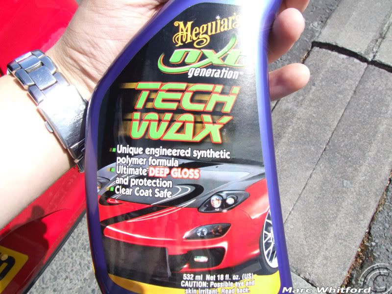

Now that the whole car is dry it is time for the wax. I Will be using Meguars Tech Wax for my car as its non metallic, this wax can also be used on metallic cars with great results, but depending on your preference Autoglym do a great Deep Shine Polish for metallica cars.

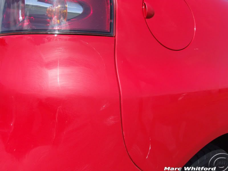

People apply wax/polish in different ways, but the most affective method is swirling, applying the wax in circular motions to the bodywork.
http://i3.photobucket.com/albums/y54/Marc_CRX/2007_05180013.jpg
Since when using a wax you must let it dry before removing it, doing each half of the car separately to ensure easy removal of the wax, be sure that the wax goes from a clear coat to a haze before removal.

remove the wax in the same way that it was applied, this ensures the wax is applied well to the paint.
