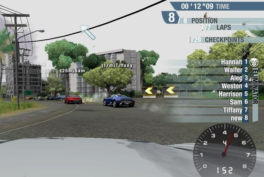

This mod will make  opponent AI a bit faster and smoother.  Use exe data shared by tasos007007 and more importantly new AIBotPers.xml and optimized path in AIConfig.xml. The data of AIConfig.xml is tweaked for hravy car, to make it less likely to go off track.
4 files must be replaced / modified in order this mod to work properly. FX.ini, TestDriveUnlimited.exe, AIConfig.xml and AIBotPers.xml.

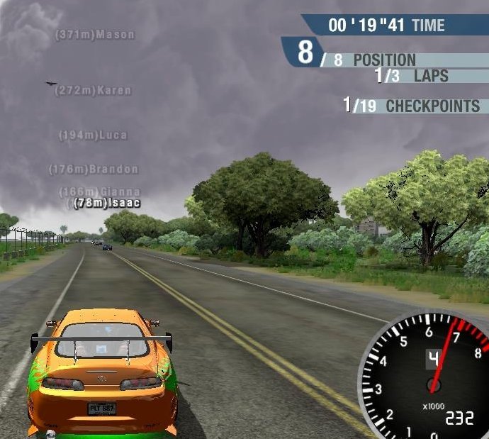

AI is especially fast in:
- Last Man Standing, you may not win with Ferrari 575M
- Ring of Speed, you may not win with fast furious Supra
bug = traffic is somehow messed up. seems to be faster too.
The AI is still rather conservative, mainly to allow as many cars as possible to stay on the track.
