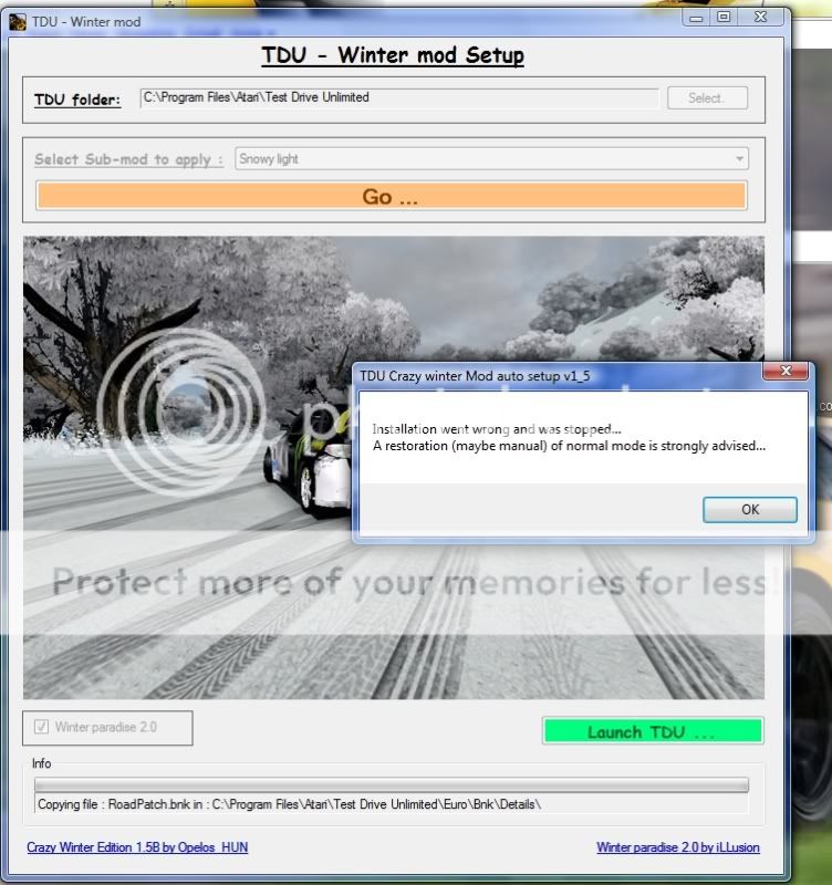

Hello,
Which version of windows are you running ? It is probably a question of user's rights. In the readme file, there are some instructions concerning the rights to give and the readonly tag to remove on TDU folder and subfolders. On the picture I can see the soft could not copy the 'roadpatch.bnk' in '.../euro/bnk/details'. There's no reason for this except a rights problem...
Normally, the installer has made a backup of your files in ".../TDU winter/TDU normal mode".
What you must do now (if I'm right) :
- change the rights to 'full access' for 'user' if using Win7 or Vista
- remove the readonly tag for TDU app. folder and subfolders.
- Use the 'restoration normal mode' of the installer to replace correct files.
I strongly advise (all of) you to read carefully the readme file. There are very important rules inside to get everything working.
In case you don't manage to restore the 'normal' mode and you don't have a backup of your TDU folder, I will send you the files needed and the procedure.
By the way, if you manage to get it working, you should get the "TDU seaon", which is an upgrade of "TDU Winter" and has a logfile... really better to troubleshoot the problems. It's also more securized if you try to bug it (like trying to change the mode while TDU's running) !!!
Be careful if you do this, YOU MUST BE IN NORMAL MODE TO UPGRADE...

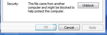

I unchecked all readme's now. One thing that I did notice was this:
http://i900.photobucket.com/albums/ac202/LP670-4_SV/Block-1.jpg
I unblocked it. Could that help in any way?
Maybe for decompressing... but this file is not involved anymore in the process.

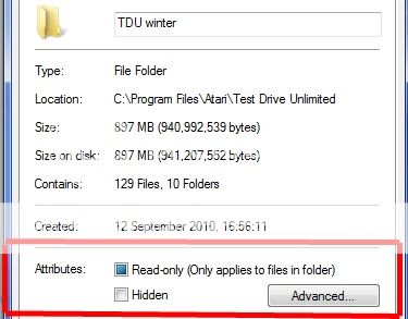

Looking through now, all of the folders (TDU winter being one, is that right?) have reticked that box! Everytime i untick it, it re-ticks.
Yeah I changed it to that.
Everytime I uncheck it, click apply then ok (or just ok) it checks itself again. Even with full permission. No matter what I do it still doesn't seem to like me. :(
This is the cause of the problem you got.
I cannot help you on this matter as I only own a XP version, thus don't know how to get the right to change this.
If you manage to set and keep this ReadOnly tag unchecked (for TDU folder AND subfolders), you'll get my app working (just re-set any winter mode in the program to recover).
Tell me (us) when you manage to do it. It will help others for sure.
