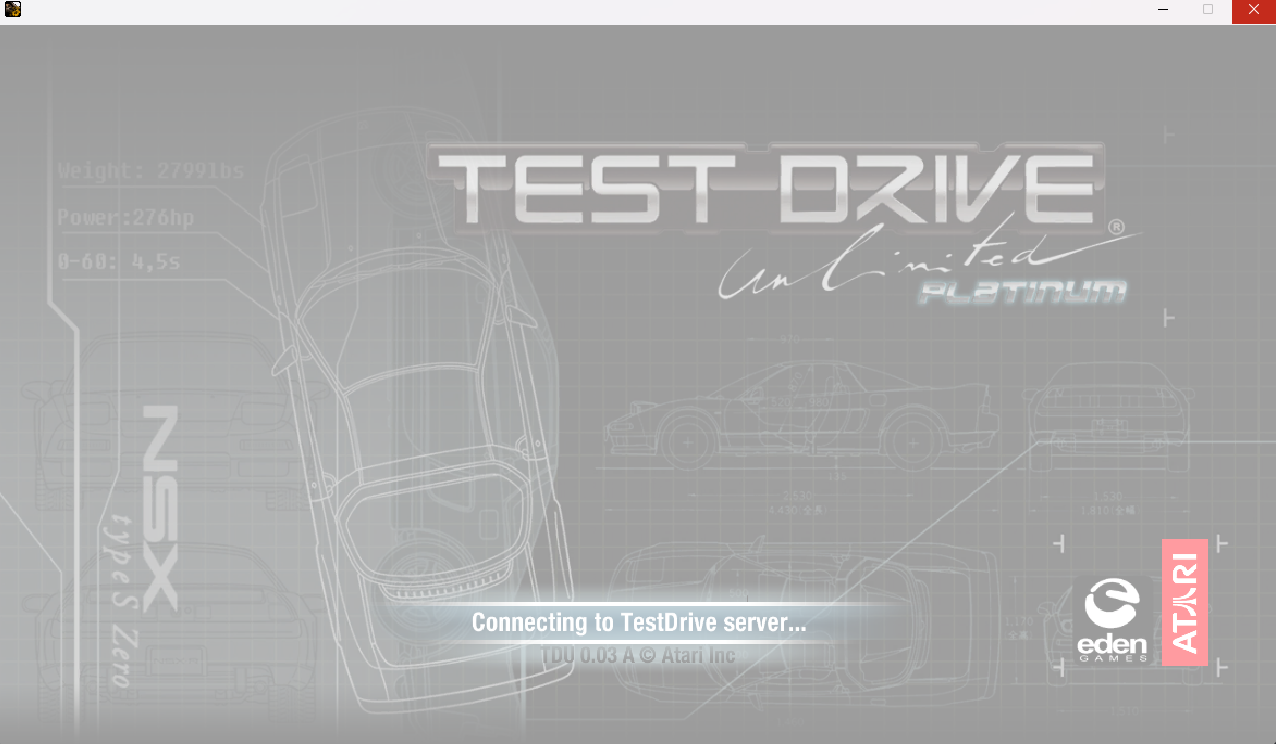

When creating an account you have the option to go online when you create a GameSpy account (which is long dead, I know).
Anyway, I tried to give it a shot and put in some emailadress and password but when the game wants to contact the servers it can't make contact.
Now I would like to know if you can play online multiplayer with TDU Platinum and how I should do it and wheter it is even worth it regarding the playerbase (if it's more than 1 besides me I'm okay with it 😄).

Hey man, thanks!
Good to know you can still play online. 😄
I'm online now. 🙂
My mistake was I replaced the d3d9.dll with my own generated by SweetFX.

15 hours ago, Estevaoportela said:
Other players' cars turn red on the map and I can't find anyone.
Hey! This is a Old game. Even the players are showing on the map and how good connection you have it dosen't matter. the game needs to connect with the server
you can drive until the game connects this may take 5 or 7 minutes to connect. In my Opinion

bro how can you play online i dont have a gamespy account
hello i was wondering how you could play the game online, i don't have a game spy account and was not able to understand the FAQ that included questions about the multiplayer, if anyone can help i appreciate it.
You do not need a Gamespy account (the service no longer exists), but you will create a fake one in-game when setting up your profile.  If it fails to connect, try again while using any public VPN.
I've used and still not working online.

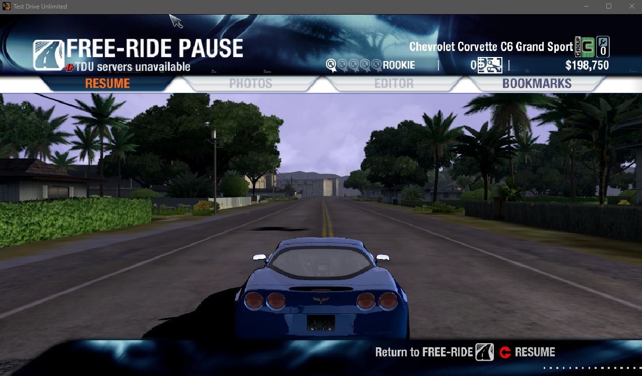

I have a similar question about online. might be a noob question but how come i cant see any multiplayer races? or clubs or drive-in's.
there are no clubs and drive ins. also there is no online marketplace.

4 hours ago, Hariel said:
Hey bro, help me, I downloaded Project Paradise to play online, but my friend has a white name and it keeps blocking his car
Check your Internet connection, it may be too weak, which may cause a similar problem
just his car, and it looks like a symbolic socket disconnected like this -//-
This icon means that the player has a bad Internet connection and therefore his car may not be displayed correctly for others
