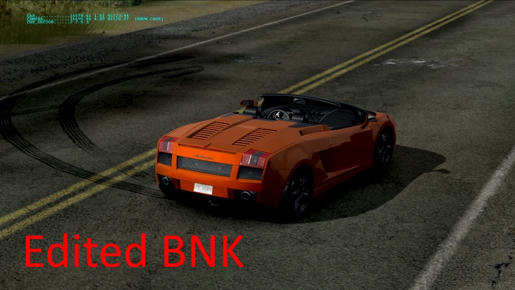

@ BeSweeet As of yet to my knowledge nothing. The main issue was getting roads to import and export correctly.
But Oleg edited the tdu1 source to import 3 UVs correctly but it wasn't exporting 3 UVs or importing/exporting the material settings correctly.
So then i simply edited the source to export 3 UVs no matter what the material settings were which worked. But then had to edit the material.2DM with material editor.
I told Oleg this then he spent almost 5 hours on teamViewer making import and export of roads work correctly.
I can't thank Oleg, Djey and Speeder enough for making this possible. :D
That is a picture of my edited source build/edited material.2DM. Seemed a waste of time uploading a new picture as it would be the same.
I was thinking smaller to start with. So i can work out the best way of going about it. As the chances of me getting efficiency from the start isn't going to happen.
If you want to give me a bumpy road sector name so i can smooth it out that would help. Then people can test it and give feedback.
